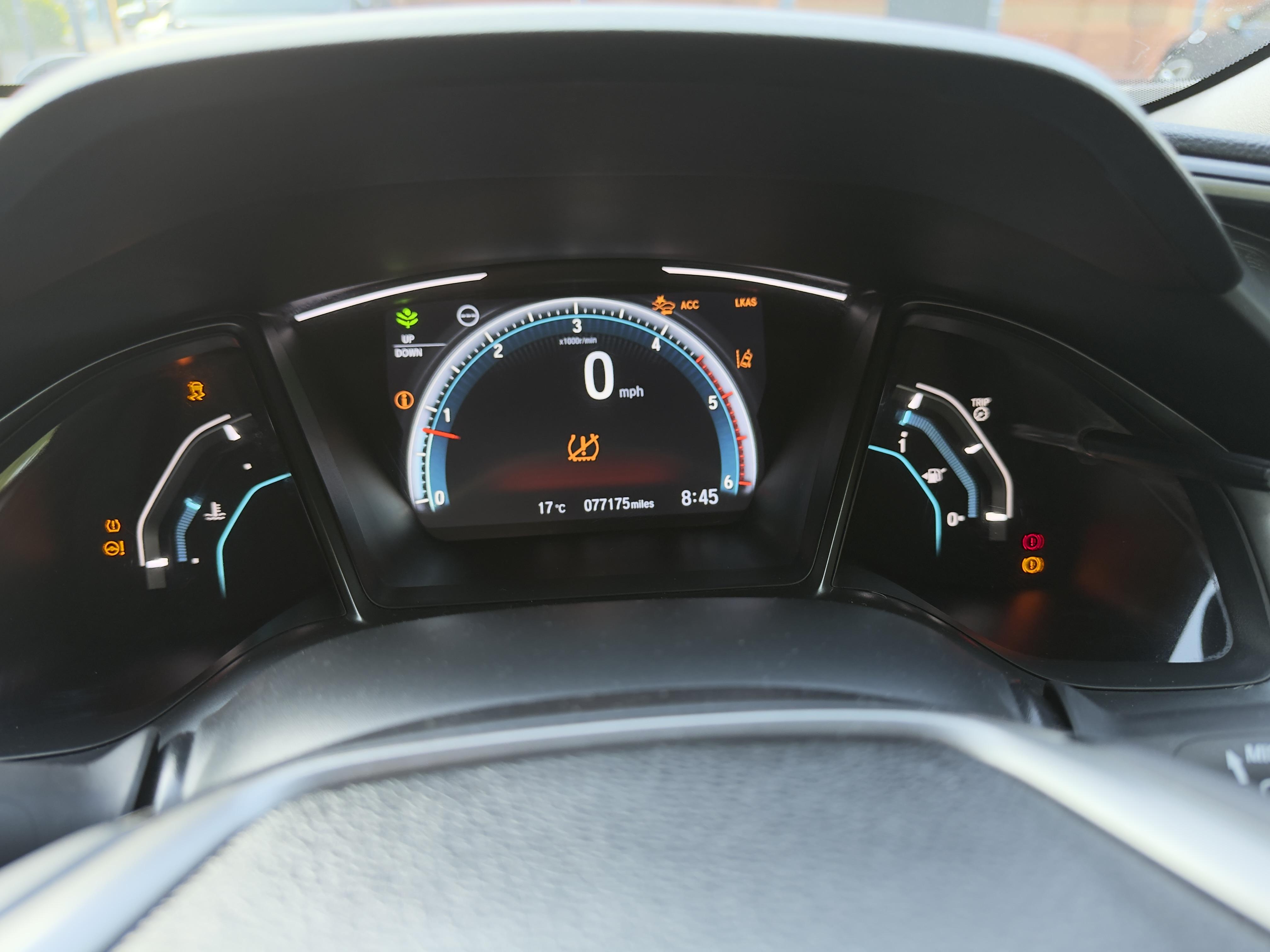

All orange warning lights coming on every so often.
For the past 2-3 months, every so often all of my orange warning lights have been coming on my car, followed by another orange light that says "please wait, system initializing". My garage seems to think that all of the sensors are connected to this "system" and that if one of them is faulty (they told me an ABS sensor, i've had one replaced but they seem to think it's another one now) it will set all of the lights to come off, but I'm not 100% sure with that, can anyone help? Thanks!

Hi, I recently changed my Honda civic 2020 battery and after some hours my Amber warning light pops up so I took it to a battery specialist to make sure the battery was a good fit and all seemed fine so I was then advised to remove battery connections for 10 minutes so it restart everything things but Amber warning light still pops up at random but car seems to drive pretty well and I’m worried whenever light comes on

Finally found the problem. It was my passenger’s rare ABS sensor, which had debris and was cleaned properly. All warning lights never came back.
