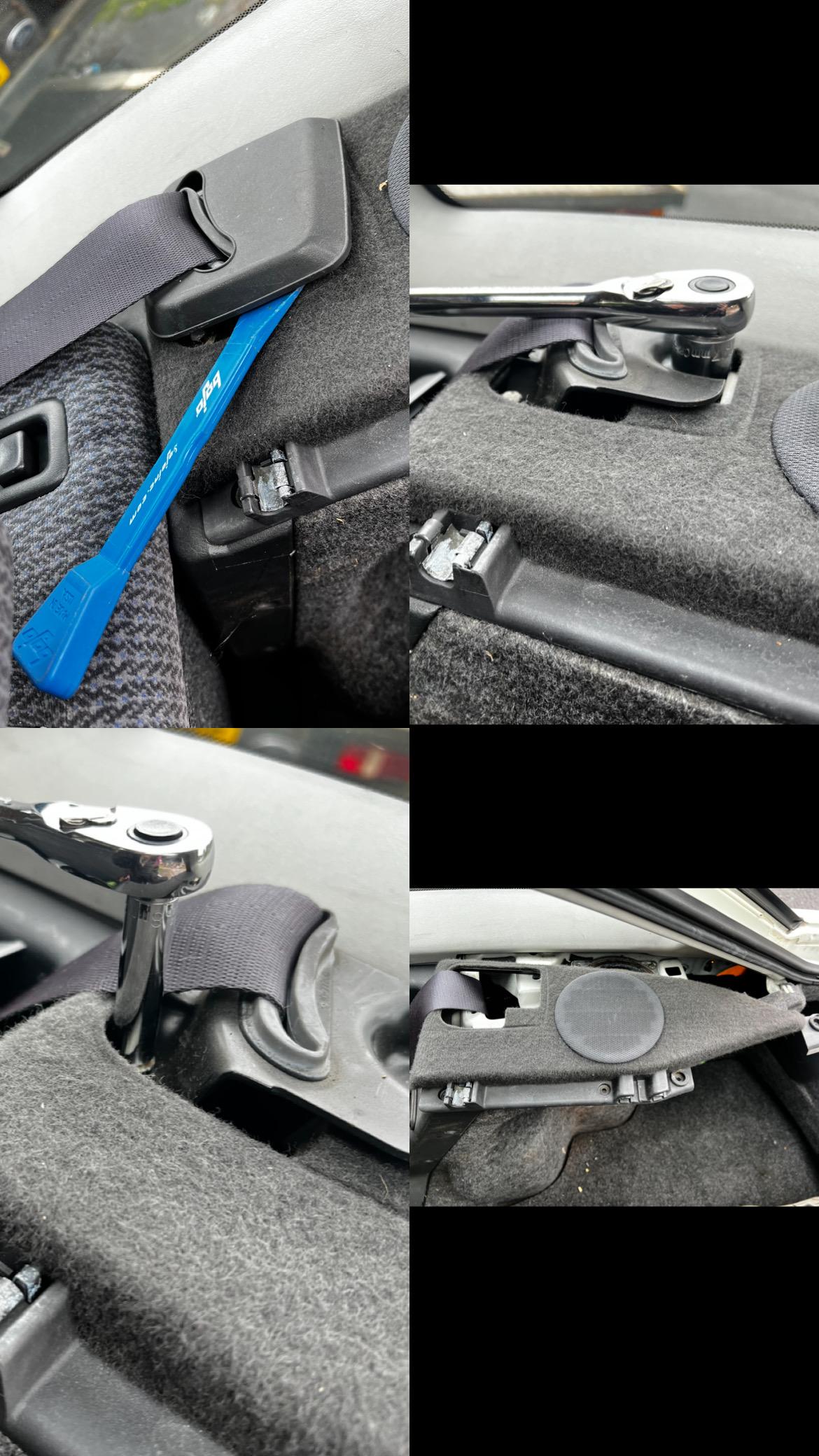

the speaker is underneath the plastic shelf. To remove this you will need to undo 4 pozzy head screws, this will then undo the shelf.
However,
You will need to fold the seat down, and using a plastic trim tool. Pop off the plastic top off the seatbelt guide.
once this is done,
There you will see a 17mm bolt and a 8mm nut that you need to remove to undo the seatbelt runner/guide? This will then give you access to slide the plastic shelf covering the speaker off.

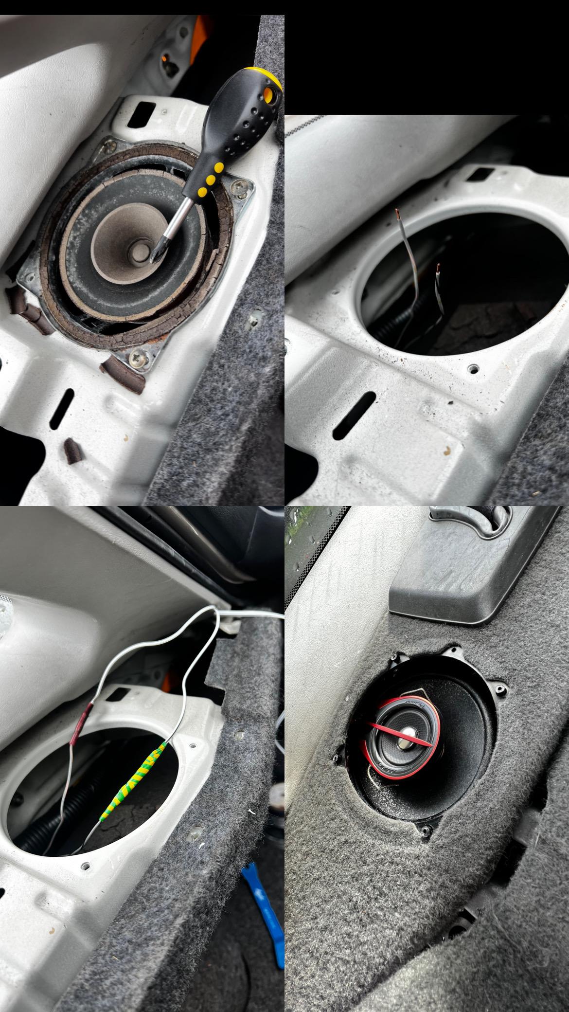

Once you have removed that, you can then using a screwdriver undo the 4 screws holding the old speaker in place & begin with connecting and fitting your new set in.
What size speaker?:
for the rear I literally just bought the Pioneer TS-R1350S. They are 13cm and are the perfect fit.
And for the fronts, I reckon you could go to the next size up.
funnily enough, I did not take pictures of them fully fitted. ( it started raining ) But I can add a picture of them later on, ( take it from me, don’t remove the circle speaker top😂 as they will just snap :’) ( nothing a bit of super glue won’t fix - don’t @ me haha 3F137973-615C-4218-8BDB-894467C056AB.thumb.jpeg.ff40eec29a61eb4cffc8cb25581563d5.jpeg8B7CD389-ADF1-45E8-B2CD-4BA0F45E862F.thumb.jpeg.a50a9978fa332e1efe9ef638140032a0.jpeg
