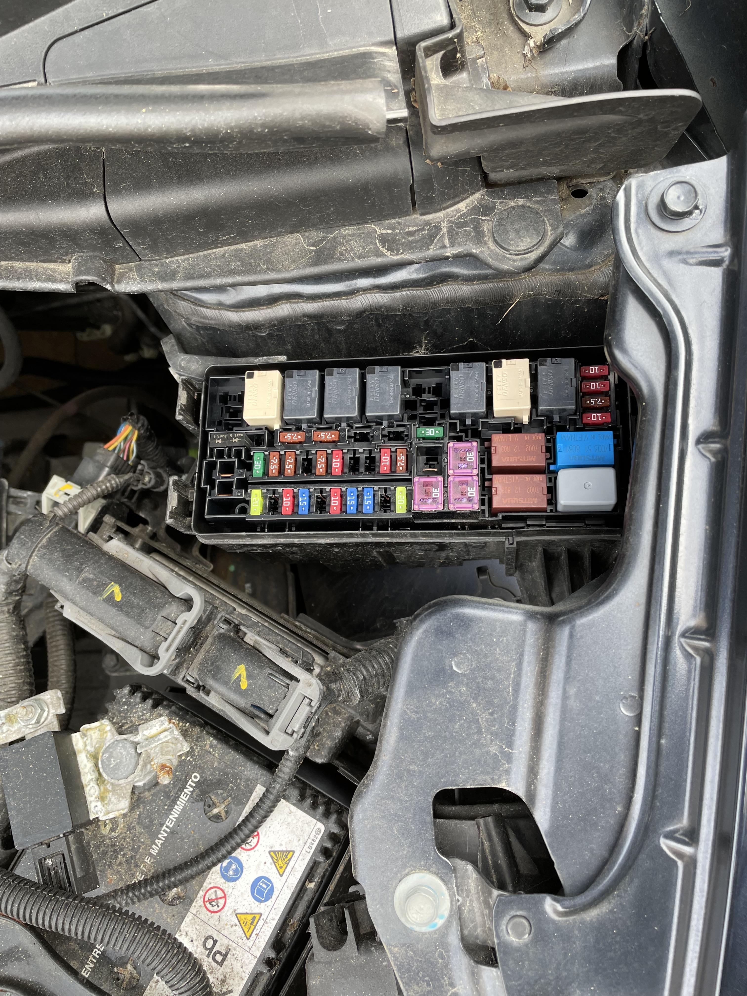

Hi there I’m a new member. I have a 2019 20000 mile 1.3 Petrol jazz. It currently won’t start all it does is keep cranking even when you release the key

I thought the same but trying to find out where it’s located is another story. There is some relays in the fuse box under the bonnet but nothing on the fuse box lid to say what fuse and relay locations are.

Thanks for the photo
I do wonder if there is any water ingress into the fusebox as it is in the scuttle area where the water could enter into the fusebox and contaminate the relays.
I would remove the relays one by one and examine them for any corrosion of possible contamination from water ingress. Also check the terminals in the fusebox as well and maybe if there is some contamination then apply silicon to the fusebox cover before refitting
