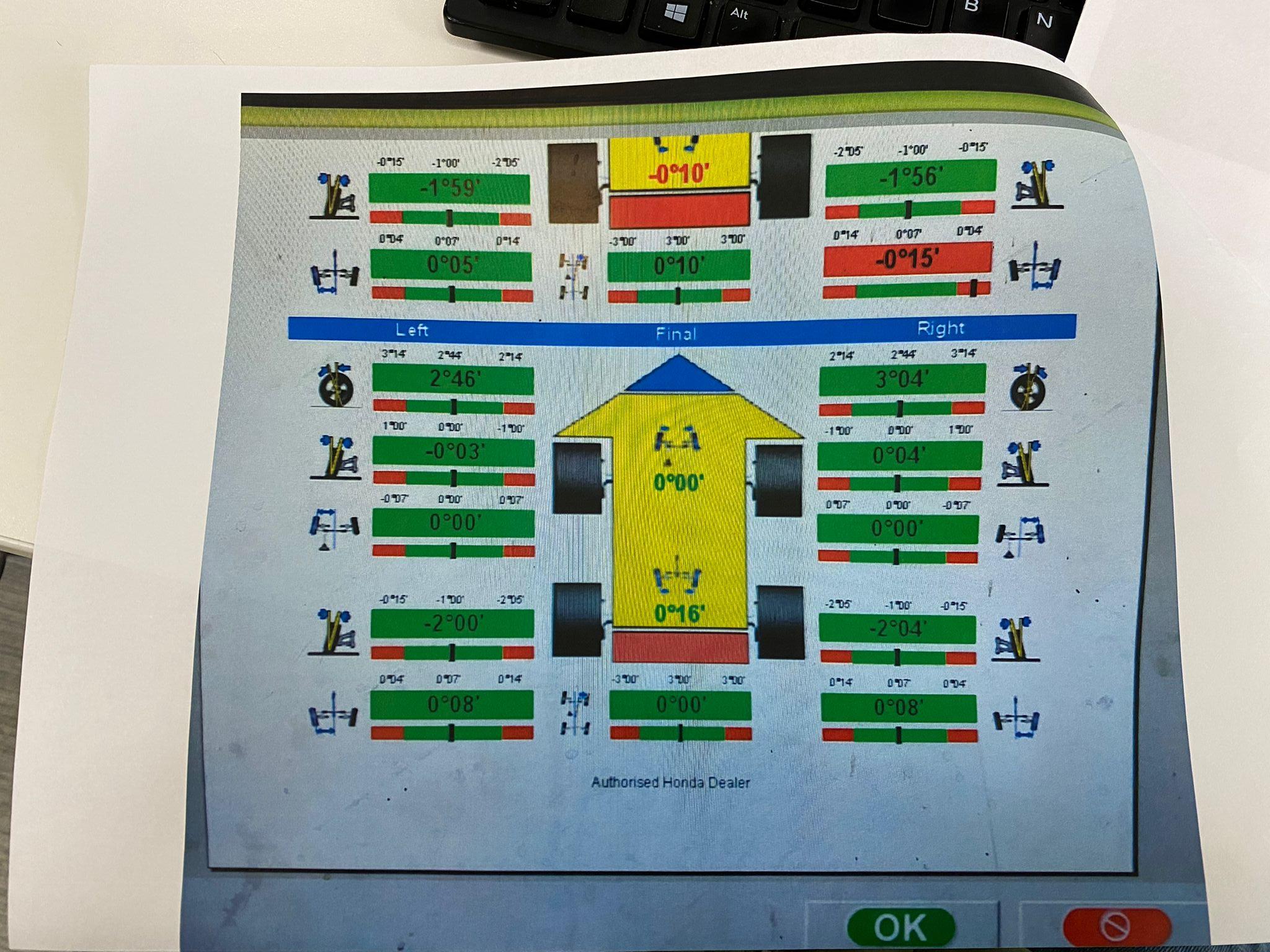

Zain Posted April 27, 2023 Author Posted April 27, 2023 On 4/26/2023 at 8:13 AM, Trevor said: Hi Zain ... welcome to the Club I had this issue on my 2007 CR-V and it was the rear suspension that needed adjustment to rectify the pulling. The natural camber of the road is that it pulls to the left and got annoying to have to hold the wheel with my thumb constantly resting on the steering wheel. With some adjustments to the rear Toe, the issue was sorted. The rear suspension arms have some adjustment bolts (from memory you loosen the outer nut and adjust the inner bolt to alter the Toe The trick is to adjust the rear suspension before the front, most garages just make adjustments from the front and this accentuates the pulling even more so. Do you have any printouts from the previous alignments which you can post up so I can look at the figures? Hi Trevor, Thanks for the reply, much appriciated. That does sound interesting. Here is the reprot from Honda once they were done with the alignment. Thanks
Trevor Posted May 1, 2023 Posted May 1, 2023 The results once the alignment has been done are in fact fine. They weren't and that would have caused the veering
Zain Posted May 16, 2023 Author Posted May 16, 2023 Thanks for the reply... Can you think of anything else which might be an issue?
Trevor Posted May 19, 2023 Posted May 19, 2023 Unless you can get the alignment altered to compensate for the UK camber and bias it slightly over one way? Otherwise, tyres may make a difference possibly?
