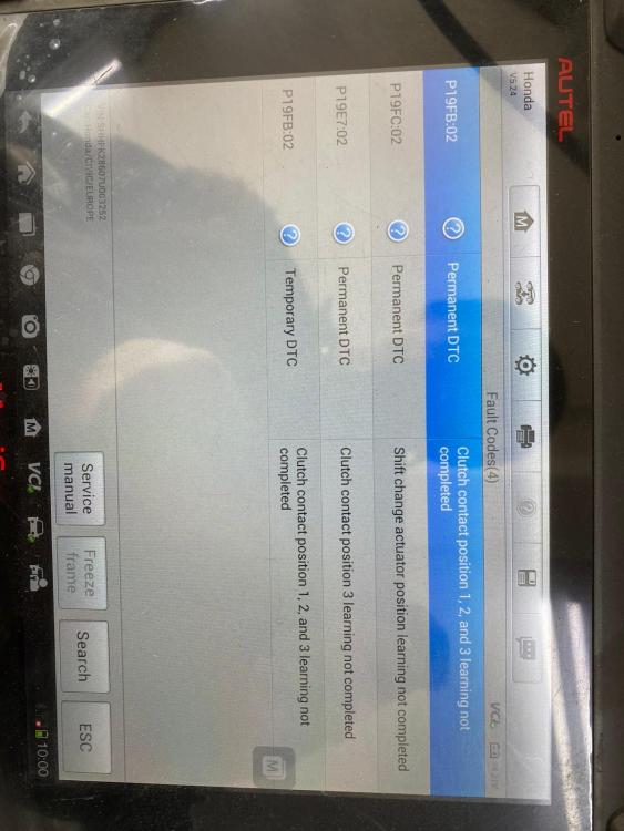

Finally got the actuator repaired but after fitting it back in its now coming up with these codes. The chap who fixed it says the clutch also needs replacing, my mechanic doesn’t believe it’s the clutch. Anybody else have this issue?
  • Author
Never thought of that.
That’s the last thing I need after forking out to fix the actuator. Not sure if it’s worth Paying for a new clutch but will have a think.
thanks for the feedback mate
