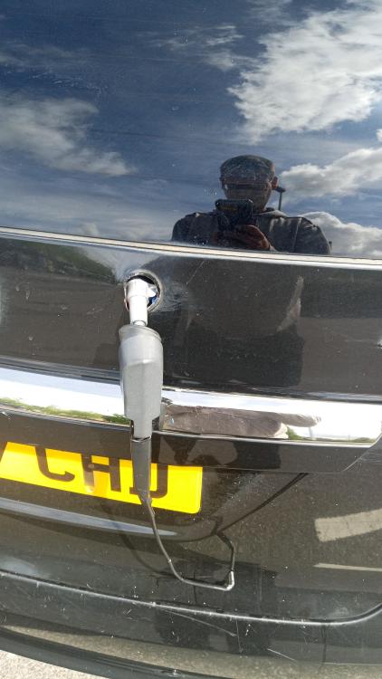

I have got a similar problem on mine. I went through a car wash which somehow managed to rip my rear wiper out and damaged wiper, wiper arm and broke the motor.
Since I can only operate windows if my windscreen wipers are off. If they are on they do not work?
Any idea what could that be?
Also where would you recommend for me to buy replacement part as above.
