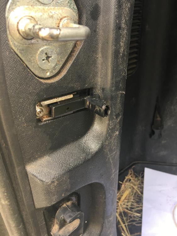

However I started doing some more logical testing as to when the door locks was activated.  My analysis was:
1.0.  The locks only triggered after 30 sec if the large back door was open.
2.0. Then I started looking the door sensor (see photo).  The spring on that has come off so when the door is opened the lever doesn’t retract to the open position.
when I manually slide the lever to the open position, the doors don’t lock.
Could be I have cracked it, just need either a new lever or a compatible spring.

Its likley to be the door switch. Basically, your car doesnt know the door has been opened so, re-locks the doors incase you accidently unlocked it in your pocket.
My renault trafic did it, was a door switch. Id imagine its, as your picture, that.
